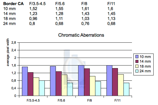

With maximum values of around 1.6 pixels at 10 mm, the level of lateral CAs (color shadows at harsh contrast transitions) can be considered moderate for an ultra wide angle lens. Interestingly, stopping down does not have any influence on the amount of CAs, and with longer focal lengths CAs drop only slightly to values just below 1 pixel at 24 mm. CAs can easily be removed in post processing, though, and some of the newer Nikon DSLRs already do this in camera (if you shoot JPG).
