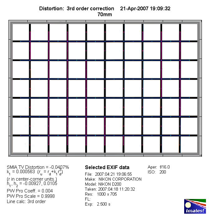

The Micro-Nikkor AF 70-180mm f/4.5-5.6D ED shows an unusually low level of distortion for a zoom lens.
At 70mm the lens is basically free of distortion and beyond there is only marginal pincushion distortion (<0.5%).

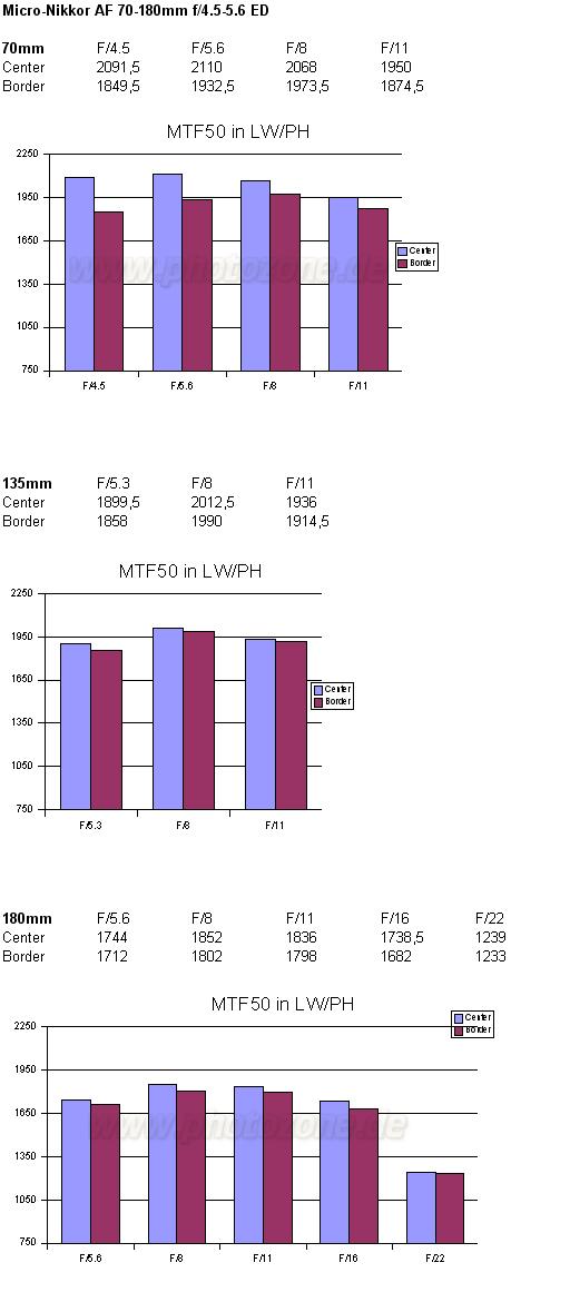

Within this scope the lens was able to deliver very good although not
exceptional resolution figures in the lab.
At 70mm the quality is excellent in the center and very good at the borders.
At 135mm the center suffers from a slight performance penalty but the quality
remains easily in very good territory. As to be expected the resolution figures
decrease further at 180mm - still very good but not impressive for a pricey
lens.
The lens has a min. aperture of f/40 - a rather theoretical setting. At 180mm f/40
the measure resolution is 720 LW/PH which isn't really something that could
be called "resolution" anymore. Due to diffraction this is an absolutely normal
behavior though.

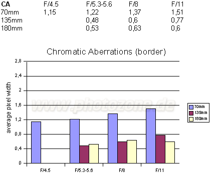

Lateral Chromatic aberrations (color shadows at harsh contrast transitions) are
relatively well controlled. At 70mm they're more pronounced (1.15-1.5px on the
average at the borders) whereas the issue is fairly negligible at 135mm and 180mm.
