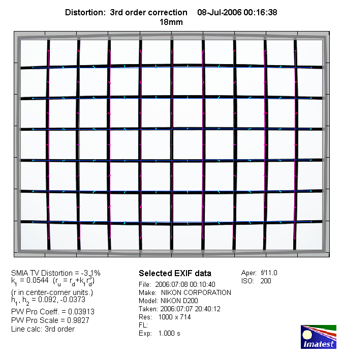

At 18mm the Sigma shows a quite hefty degree of barrel distortions (3.1%) which ease continuously towards the long end of the zoom range. At 50mm there's only a marginal degree of barrel distortions.
18mm 28mm 50mm

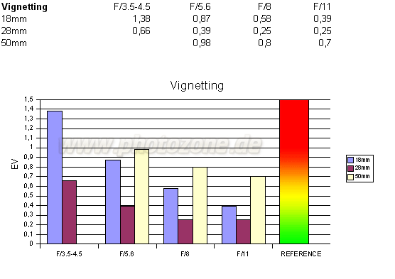

Typical for most true APS-C lens there's some vignetting at wide-open aperture. However, it is interesting that the level is a magnitude worse compared to the Canon variant - this does surely originate in the slightly smaller cropping factor (1.5x on Nikon vs 1.6x on Canon). At 18mm @ f/3.5 vignetting is very obvious and it is a good idea to stop down beyond f/5.6 at this setting. At 28mm the issue is quite well controlled whereas at 50mm vignetting is surprisingly high and stopping down doesn't really solve the situation here. It seems as if the lens is a little under-designed for 1.5x APS-C DSLRs in this respect.

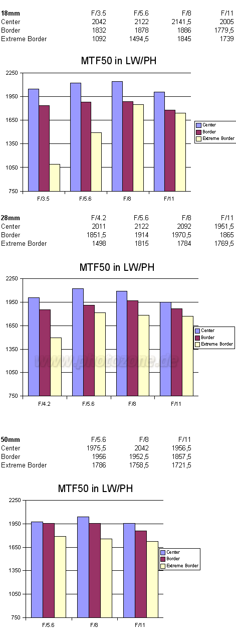

The lens produced surprisingly good resolution figures in the MTF lab. At 18mm the center performance is superb and the borders are also very good. The extreme borders are somewhat soft at f/3.5 so this setting should be avoided if possible. However, stopping down does improve the quality substantially here and at f/8 the figure are very good. The field curvature is quite pronounced at this focal length. At 28mm and 50mm the performance is more even - the center resolution decreases slightly whereas the borders and the extreme borders are generally very good.

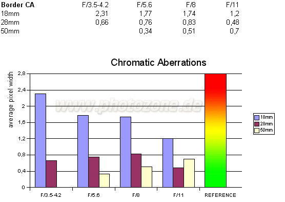

Chromatic Aberrations
The lens produced a rather extreme degree of chromatic aberrations (color shadows at harsh contrast transitions) at the image borders at 18mm. Stopping down helps to ease to problem a little here. At 28mm and 50mm the problem is well controlled.
