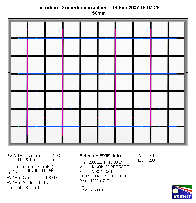

Macro lenses are renowned for minimal distortions and the 150mm f/2.8 APO EX is no
exception here - the degree of distortions is absolutely negligible.
