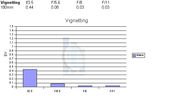

The Tamron is a full-format lens so it can take advantage of the usual sweet spot effect when used on an APS-C DSLR. Generally vignetting is no real problem even at f/3.5 and at smaller aperture settings it is a non-issue.

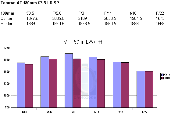

Typical for most macro lenses the resolution characteristic is very impressive. At f/3.5 the quality figures are already on a very good level. Stopping down results in a further increase in resolution till reaching an excellent maximum around f/8. At f/16 the quality is a still on a very good level whereas f/22 suffers from a higher decrease due to diffraction effects (a physical limitation). f/32 (not shown below) should be generally avoided.
Please note that the MTFs charts below represent the performance near infinity focus. For the time being dedicated macro performance tests are not possible.
