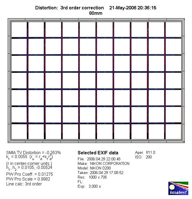

The AF 80-200mm f/2.8D ED has a very moderate zoom ratio and the level of distortions is pretty moderate accordingly. At 80mm there're marginal barrel distortions (0.35%) changing to moderate pincushion distortions at 200mm (0.77%).
80mm:
135mm:
200mm:
