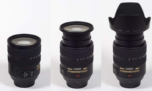

The mechanical construction of the lens is closely related to the new AF-S 18-200mm VR (or vice versa). The build quality is decent but nothing to rave about due to the extensive usage of average quality plastics. Both the zoom and focus action feel reasonably smooth across the range. As you can see above the lens uses a duo-cam design to extend towards the long end of the zoom range and attaching the supplied petal-type hood adds a few cm. Thanks to an IF (Internal focusing) design the front does not rotate so using a polarizer is no problem. The lens features a silent-wave (ultrasonic) AF motor resulting in fast and near silent AF operations.
