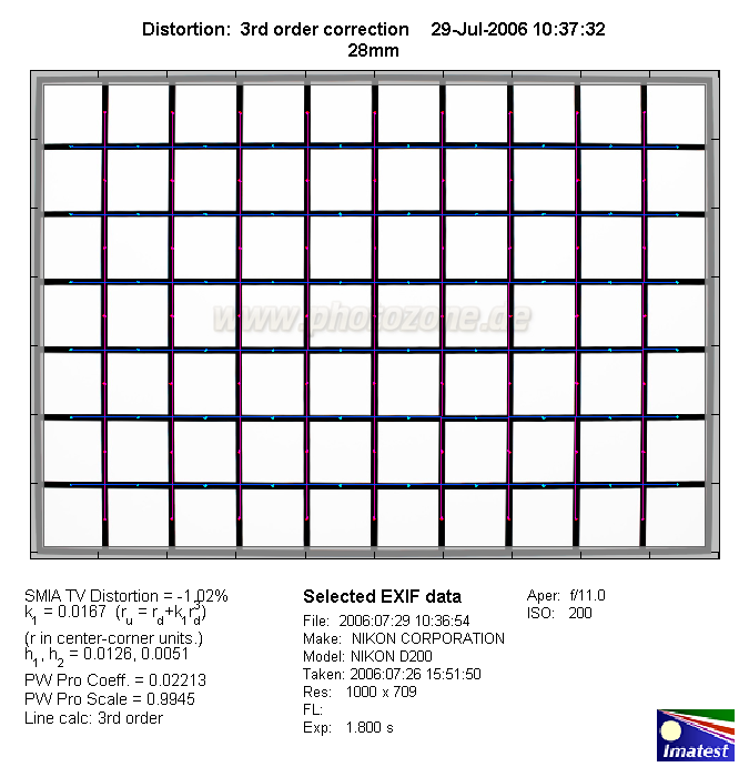

The AF-S 28-70mm ED exhibits a very slight degree of barrel distortions at 28mm decreasing to marginal distortions beyond. This is exceptional for a zoom lens.
28mm 40mm 70mm

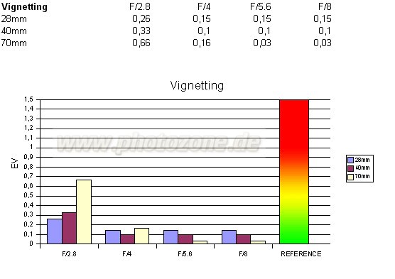

Thanks to the full frame design the Nikkor AF-S 28-70mm ED shows little vignetting on the D200. At 28mm and 40mm the issue is already negligible at wide-open aperture. Interestingly the vignetting increases towards the long end of the zoom range - probably a side effect of the camera sensor characteristic. In very critical situations vignetting may be visible at f/2.8 here - by f/4 the problem is gone already.

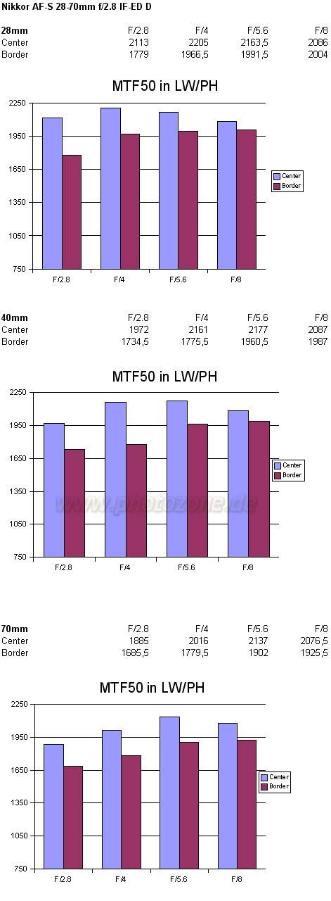

The AF-S 28-70mm f/2.8 ED produced very good to excellent resolution figures in the MTF lab. The center resolution is excellent throughout most of the tested aperture range and at all focal length - it scratches and may possibly even exceed the sensor resolution of the D200 at 28mm @ f/4. The borders perform slightly worse than the center but catch up quite nicely when stopping down. There's a marginal decrease in quality at 70mm which may originate in a slight centering defect which is most obvious at this setting.

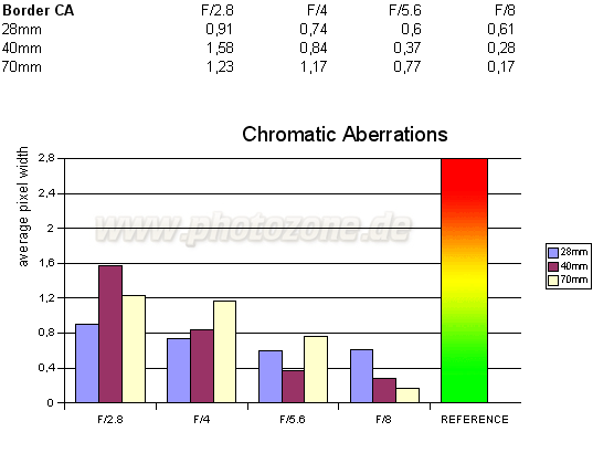

Chromatic aberrations (color shadows at harsh contrast transitions) vary somewhat across the focal length range. At 28mm the issue remains below 1px on the average at the image borders but the issue increases towards 40mm and 70mm at large aperture settings. Please note that lateral CAs can be easily corrected via imaging applications.
