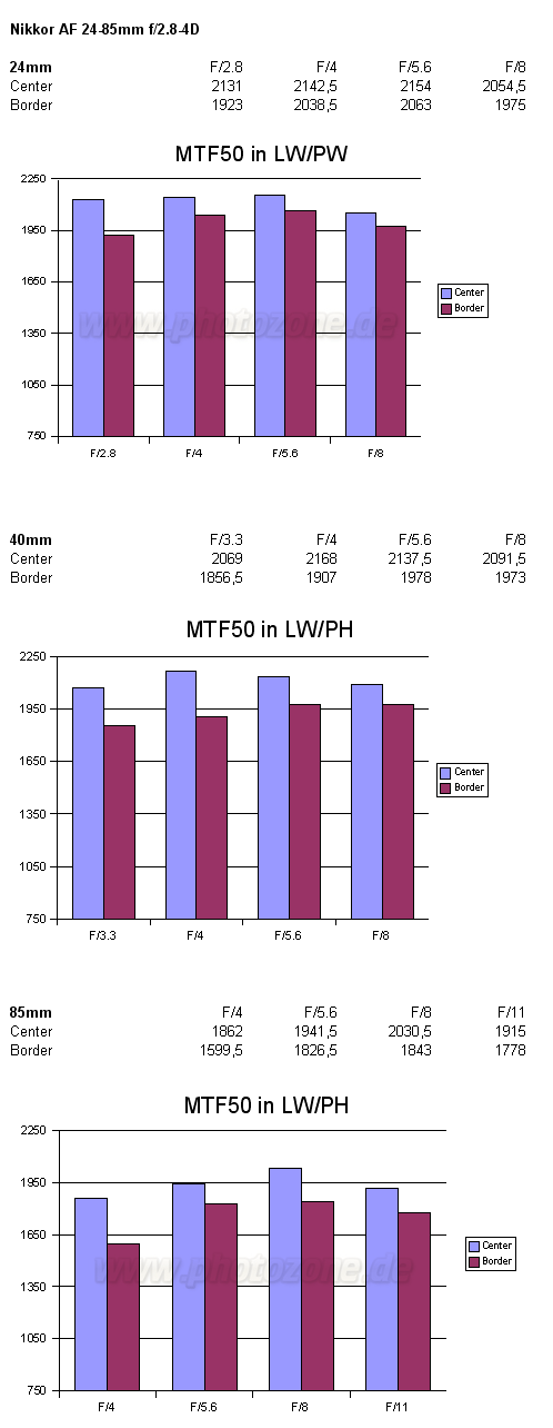

The lens showed an impressive resolution characteristic on the Nikon D200. At 24mm and 40mm the center performance is excellent straight from the max. aperture and the borders follow quite closely on a very good level. At medium aperture setting the border quality is also excellent. There´s a decrease in quality at 85mm but the resolution figures remain very good except at f/4 where the border quality drops to good levels. The sweet spot of the lens is obviously at the wide-end of the zoom range.
Generally the contrast level is somewhat reduced at large aperture settings, specifically at 85mm. The lens exhibits quite a bit of field curvature at 24mm which eases when zooming towards longer focal lengths.
