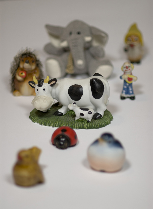

The Defocus Control (DC) Effect
In order to vary the Defocus effect the lens features a dedicated control ring
similar to an aperture ring (which is also present). The DC ring has a neutral
setting where the lens behaves just like conventional tele lenses. From here on
you can rotate the ring either to emphasize the foreground (F=FOREGROUND) or
background (R = REAR) blur. The ring locks at apertures between f/2 and f/5.6 which
correspond to real aperture settings. Turning the ring beyond the aperture in
use lets you create a corresponding soft-focus effect. This sounds difficult
an in fact you will need some experience to get the best out of this feature.
Here´s a quick and dirty overview of what defocus control can give you at various settings.
You may notice that the image "jumps" when switching between the samples. This
originates in the requirement to re-focus every time you alter the defocus control setting.
PS: No, these are not my toys - they belong to a female of the species. Just to mention ... 8-)
Move the mouse cursor over text link below to observe the respective DC effect
