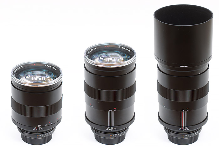

As it is the case for any ZF lens, the build quality of the APO Sonnar is outstanding. The whole lens, from mount to the supplied hood, is made from solid and high quality metal.
As already mentioned, the lens is manual focus only. However, due to its very large and superbly damped focus ring, that is partly ribbed, and a very long focus throw it is a joy to handle the lens. Hitting the right focus spot is a challenge though, due to the very thin depth of field at large aperture values. However, the focus indicator in the viewfinder of most Nikon DSLRs offers welcome assistance.
As can be seen in the product shots above, the length extends considerably with closer focus settings. As you can expect from a modern lens design, the front element does not rotate, so using a polarizer is possible without any issues (besides accessing it if the fairly long metal hood is mounted).
