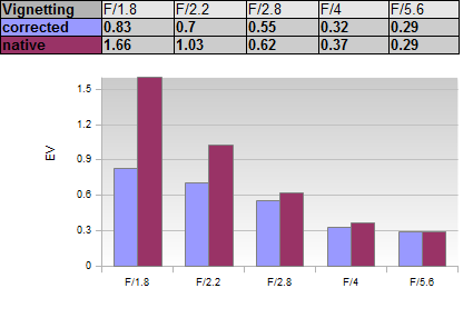

The auto-correction is also active for vignetting. JPEG images show a rather moderate light falloff of 0.8EV (f-stops) at f/1.8. As usual the vignetting decreases when stopping down and it's not really relevant anymore beyond f/2.8.
Uncorrected RAWs show a very different story with a very high falloff of more than 1.6EV at max aperture and still 1EV at f/2.2. The problem is mostly gone from f/4 onward.

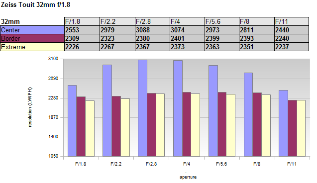

The Zeiss Touit 32mm f/1.8 delivered impressive results in the MTF lab. The image center is very good at f/1.8 and excellent from f/2.2 all the way up to f/8. The image borders/corners are good to very good straight from f/1.8 but they don't really benefit from stopping down anymore. Diffraction has a higher impact from f/11 onward although the setting remains easily usable.
The centering quality of the 2nd tested sample was good, much less so on the first sample. The field curvature is quite low.
Please note that the results were obtained from uncorrected RAWs. The quality of the (distortion-)corrected images depends on the specific converter so we decided to avoid this discussion here.

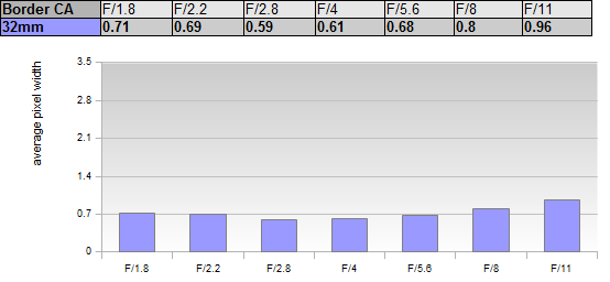

At around 0.6px lateral CAs (color shadows at hard contrast transitions) are low and usually nothing to worry about.
