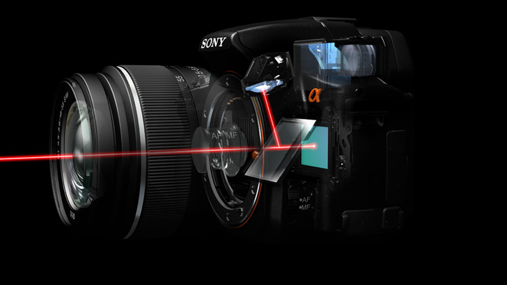

Technology Facts - SLT
What makes the Sony SLT-A33 so special? The following image should help to explain Sony’s SLT approach.
As with all DSLR cameras, the light passes through the lens and strikes the translucent mirror. One part of the light is falling on the sensor of the camera and the other part is redirected by the fixed mirror to the auto focus module. This simple but ingenious technique allows the use of live view and phase-detection AF at the same time and the elimination of the “mirror swing” allows more frames per second and reduces the risk of dust on the sensor.
With a few words - an EVIL camera with phase-detection autofocus
