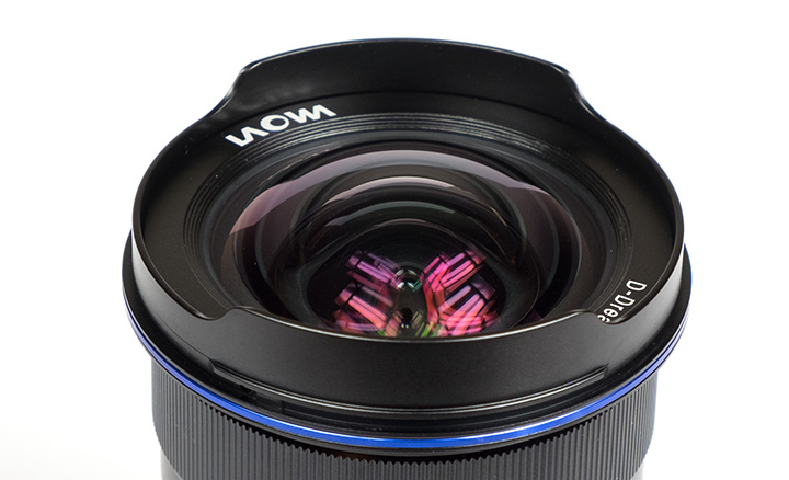

Laowa did not only manage to provide such an extreme focal length combined with a fast speed - they were also able to tame the dimensions of the lens. Despite being wider, it is actually a bit smaller than the Canon EF 14mm f/2.8 USM L II for instance and far from being a brick like the Canon EF 11-24mm f/4 USM L. Another aspect that may be surprising for some is the build quality - it is impressive (once again) and comparable to more established players such as Voigtlander. The Laowa is based an all-metal lens body with a smoothly operating focus ring and a dedicated aperture ring (the clicks are in full stops) ... which also tells you that it is a fully manual lens without electronic coupling (Note: The Pentax K/Nikon AiS & Sony A-versions will have a lever-coupled aperture according to Laowa if the camera supports mechanical aperture-control). Given the extreme focal length this is hardly a showstopper though. If in doubt you can always use magnified live-view for focus fine-tuning. Needless to say but the more you stop down, the darker the viewfinder becomes (except on Nikon-F/Pentax-K/Sony-A - see above). EXIF data is also not embedded into your images.
The Laowa lens is supplied with a detachable metal lens hood. In order to protect the vulnerable, bulb-like front element we'd still recommend to keep the hood attached for protection all the time. The field-of-view is so extreme that the hood is actually very small anyway. The prototype didn't come with a lens cap but we were assured that the final product will include one. As you may imagine the front element doesn't allow a conventional filter thread. However, Laowa will offer an optional filter holder for (expensive) 100mm filters.
