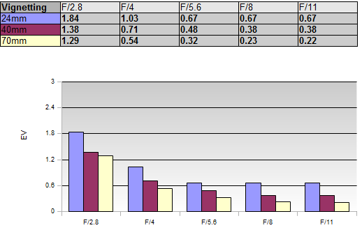

The vignetting is comparatively low within the full format scope. There's still a heavy amount of light fall-off at 24mm @ f/2.8 (1.8EV) which will be readily visible in field images. The issue is better controlled at 40mm and 70mm although it's still far from being insignificant at f/2.8. Stopping down to f/4 resolves most of the issue at 40mm/70mm and at f/5.6 it's also no longer really relevant at 24mm anymore.
