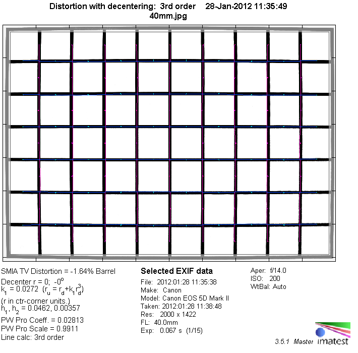

The Ultron produces a moderate amount of barrel distortion on a full format camera (1.6%) which is usually not disturbing from a field usage perspective.

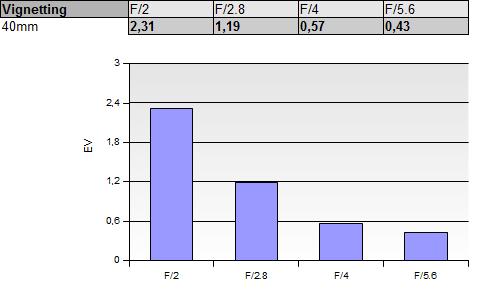

Full format DSLR are difficult partners when it comes to vignetting and the Ultron struggles here as well. The light falloff at max. aperture is quite hefty at around 2.3EV (f-stops) so unless you can live with the issue or are willing to post-correct it in an imaging applcation you should consider to stop down to at least f/2.8. There's no substantial light falloff anymore from f/4 onward.

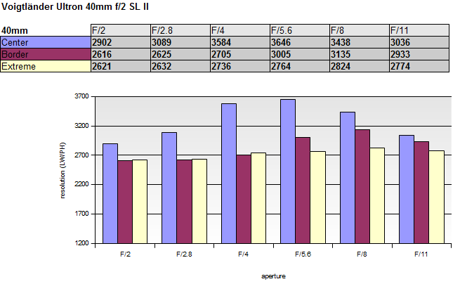

The resolution figures produced by the Voigtlander are pretty good although not superb. The center resolution is very sharp at f/2 and f/2.8 whereas the border/corner quality is only good. This isn't bad for sure - the lens is still very usable here. The center region receives quite a quality boost at f/4 but if you prefer to achieve a sharper border/corner region you should stop down to f/5.6 or f/8 - f/8 is also the global sweet spot of the lens. Diffraction has a limiting effect from f/11 onward.

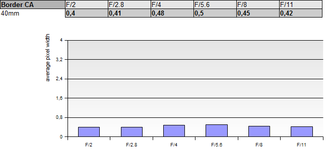

Chromatic aberrations (color shadows at harsh contrast transitions) are very well controlled at the image borders. This is actually a little surprising because we've seen slightly higher CAs in the APS-C so the issue does acutally improve a bit again in the outer image field.

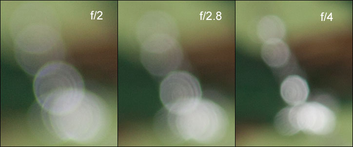

The Ultron is a fairly fast lens so it's worth to have a look at its bokeh (the quality of the out-of-focus blur).
Out-of-focus highlights are pretty circular but at f/2 they have an "onion-like" inner structure which is certainly not pleasing. The aperture "disk" is already visible edgy from f/2.8 onward.
The background rendering is also relatively nervous whereas the foreground is smoother albeit still not perfect.
