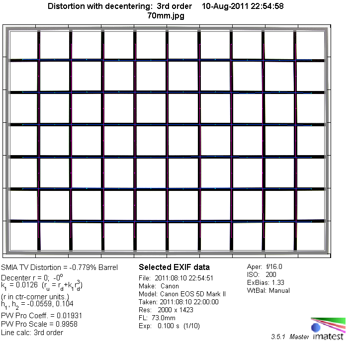

The Canon lens produces a slight barrel distortion (~0.8%) at 70mm and very slight to moderate (~1.3%) pincushion distortions in the mid to long portion of the zoom range.
70mm 135mm 200mm
