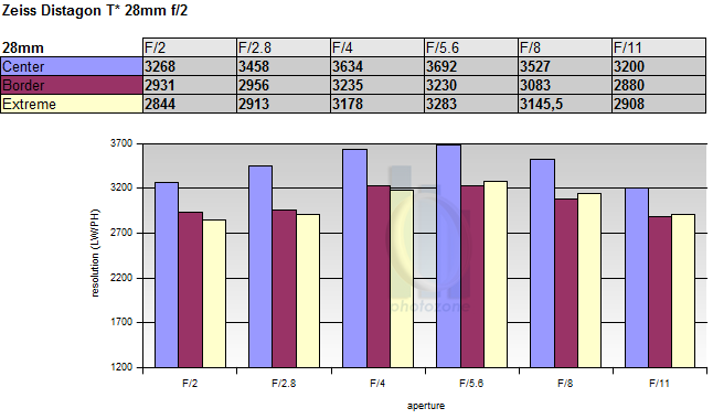

The Zeiss was able to deliver very convincing results during our resolution tests. The center performance is great straight from f/2 onwards. The borders/corners follow on a very good level. However, the lens suffers from field curvature at this setting (see next chapter). The peak performance is reached around f/5.6 with an excellent quality (just) across the frame. Diffraction effects are starting to have an impact from f/8 onwards. However, the quality is still easily usable at f/11.
Below is a simplified summary of the formal findings. The chart shows in line widths per picture height (LW/PH) which can be taken as a measure for sharpness. If you want to know more about the MTF50 figures you may check out the corresponding Imatest Explanations.
