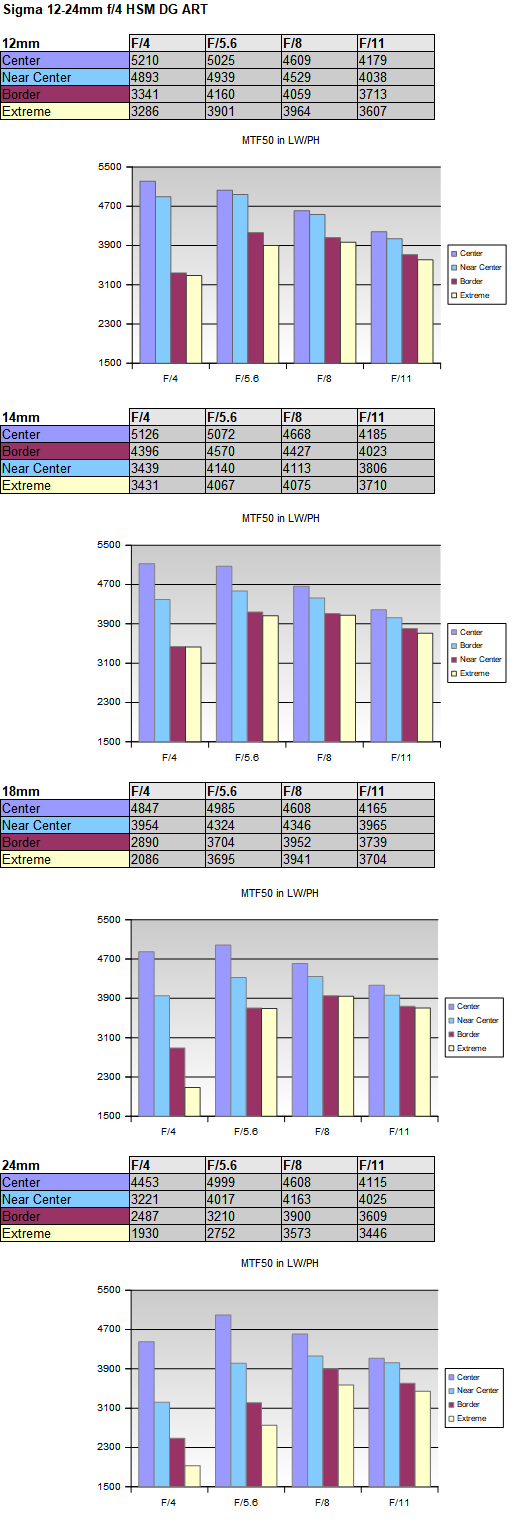

MTF (resolution) - at 50 megapixels
The resolution characteristic of the Sigma lens is very mixed. It has two souls here really. The image quality is surprisingly good at the difficult 12mm setting. The center quality is already great at f/4. The outer image field is a bit soft at fully open aperture but recovers substantially at f/5.6. Stopping down to f/8 and f/11 reduces the technical quality a bit but the borders/corners remain good to very good. f/16 should be avoided due to diffraction. The overall characteristic is similar at 14mm. At 18mm there's the first drop in performance which is most apparent at f/4 where the corners aren't pretty anymore. Stopping down to f/5.6 boosts the quality to "normal" levels. The problem maker is the "far" long end. The performance collapses here - not so much in the image center but the corners are rather unusable at f/4 and still soft at f/5.6. Sticking to f/8, better f/11 is a good idea here also because the field curvature (curved focus field) is massive at this setting - see also the next chapter.
The centering quality of the tested sample could have been better really.

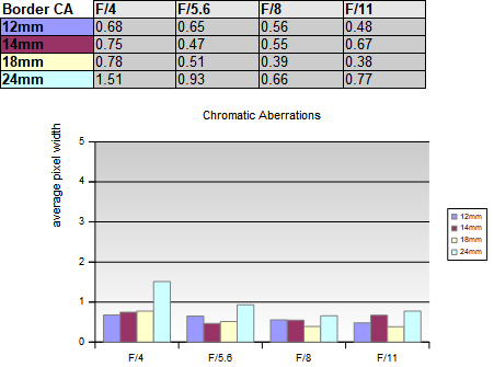

Lateral CAs are surprisingly low for such a lens. Generally they are smaller than 1px on the average at the image borders. The only exception is the 24mm setting at f/4 where the CAs peak at 1.5px but even so this is very moderate on a 50mp sensor.
