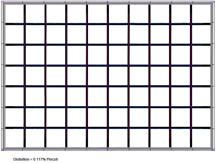

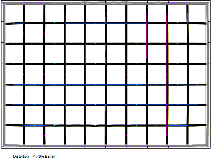

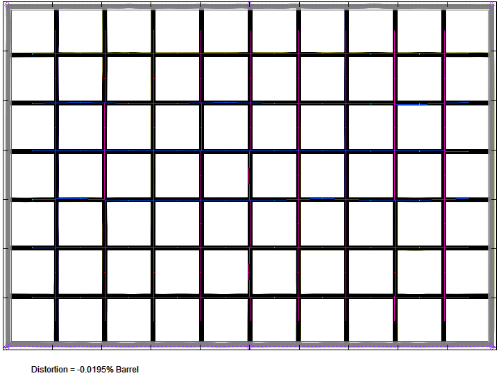

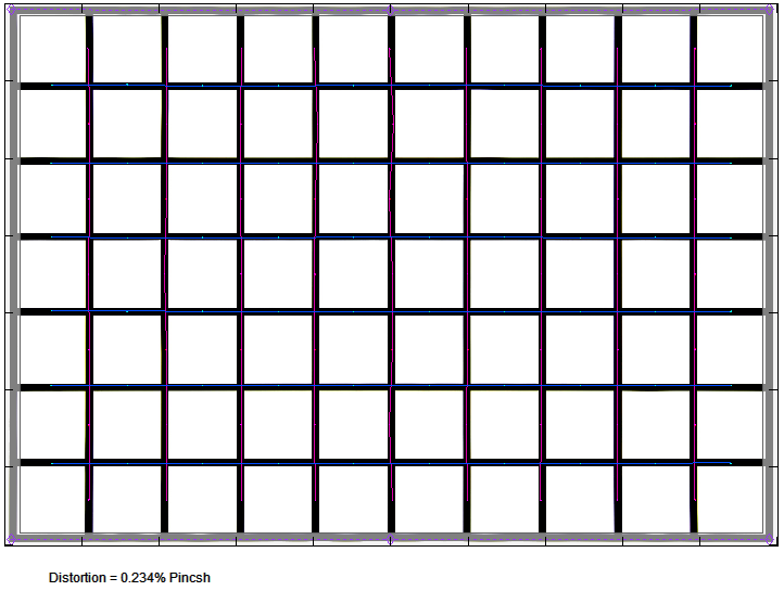

The Canon lens shows some significant barrel distortion at 11mm on full format cameras. However, the issue eases drastically in the APS-C scope. At 11mm the barrel distortion is very moderate at ~1.5% and it's a non-issue at longer focal lengths really.

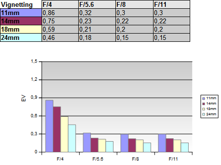

The same sweet spot advantage plays its magic in terms of vignetting. The issue isn't negligible at f/4 but not really extreme either even at 11mm. From f/5.6 onward, there's nothing to worry about.

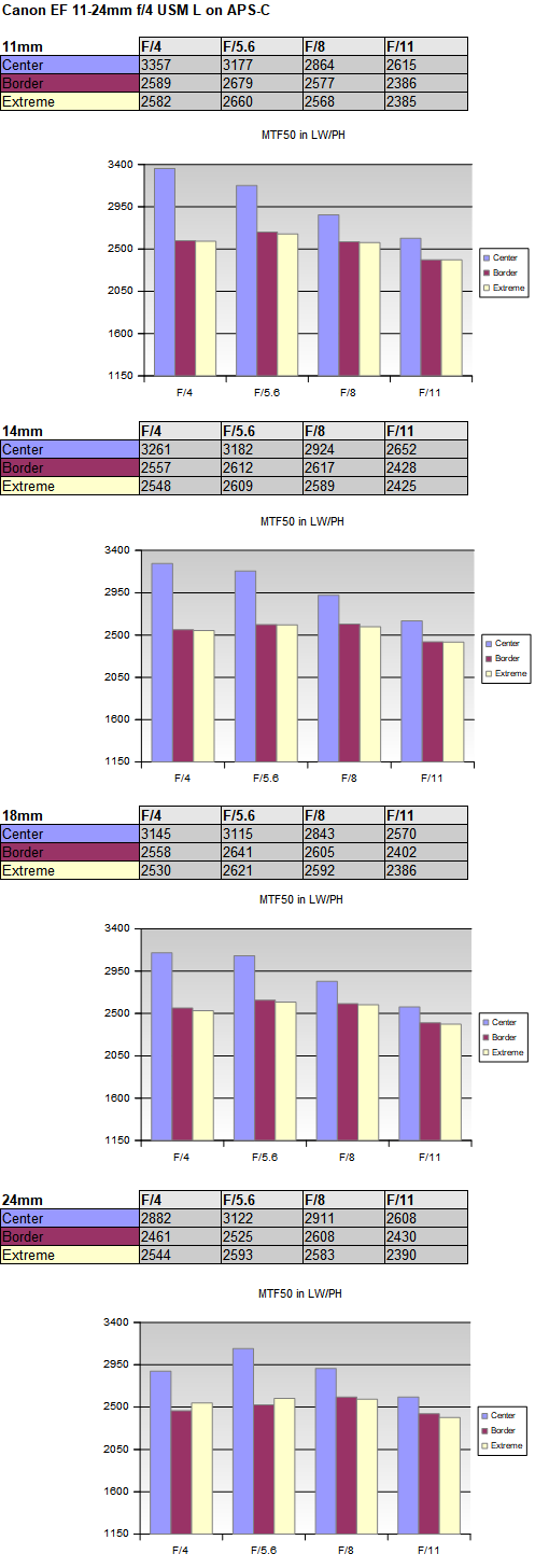

Honestly we weren't THAT impressed by the Canon EF 11-24mm f/4 USM L on the EOS 5Ds R but the task is much simpler on an APS-C format camera such as the EOS 7D II. The center quality remains absolutely stellar throughout the focal length range and at all relevant apertures. The good news is that the corners are also very good with no sign of weakness even at f/4.
The centering quality of the tested sample was good but not perfect.

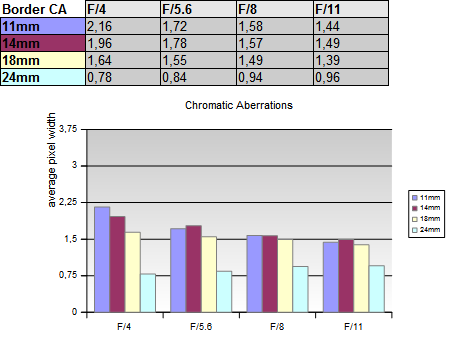

Chromatic Aberrations (Border CAs)
Lateral CAs (color shadows at hard contrast transitions) are a weakness on full format cameras and they aren't all that great in the APS-C scope either. In the low to mid range, the CAs are clearly visible with an average width of roughly 1.5-2px at f/4 and slightly less so when stopped down as well as at the 24mm setting.
The Canon EF 11-24mm f/4 USM L may have some weaknesses on full format cameras. However, thanks to the sweet spot advantage on APS-C cameras, the situation is much different here. Resolution-wise the center remains breathtakingly sharp, of course, but the outer image region is now very good even at max. aperture. There's a bit of vignetting visible at f/4 but the issue is gone at f/5.6 already. In critical scenes you may observe a moderate barrel distortion at 11mm only. Lateral CAs remain somewhat higher than expected but this aspect can be fixed losslessly during post-processing.
