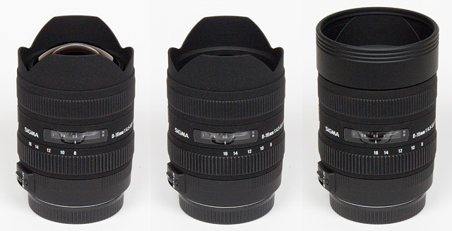

Such ultra-wide lenses with a "bulb"-like front element have not been very popular for a long while. After all it's not possible to mount front filters here. However, the design has seen a bit of revival since the Nikkor AF-S 14-24mm f/2.8 ED showed that such lenses can be vastly superior to conventional flat-front element ultra-wide lenses. Whether you like such a vulnerable front element or not is a different question of course. To be fair - the "bulb" of the Sigma is -fairly- well protected by the fixed petal shaped hood. The front cap cannot be mounted to the hood directly - there's an additional "tube" that can be attached to the lens. You may hope that this tube can remain mounted at least for the 16mm setting but you'll run into edge shading here - it's an extreme ultra-wide lens after all.
The build quality of the Sigma lens is very good - it's mostly made of tightly assembled metal parts. The two control rings have a smooth, pleasant action. The physical length of the lens remain constant regardless of the zoom and focus setting. However, the inner lens tube moves a little during zooming. The lens is also fairly unusual with respect to its dimensions - ultra-wide lenses tend to be fairly short with a large diameter whereas the Sigma is comparatively long at more than 10cm and a total diameter of "only" 75mm.
