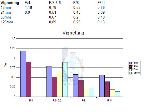

The Sigma shows the quite typical characteristic of a dedicated APS-C lens with a strong degree of vignetting at wide-open aperture at the extreme ends of the zoom range. However, stopping down to apertures smaller than f/5.6 helps to reduce the problem to unobjectionable levels.
