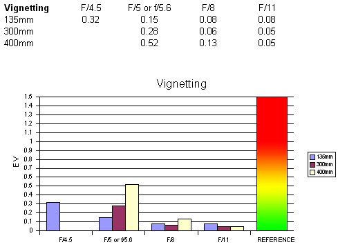

The Sigma is a full frame lens thus enjoying a sweet spot advantage on APS-C DSLRs. Between 135mm to 300mm vignetting is not field relevant even at wide-open aperture. At 400mm vignetting is a little higher but still harmless in most situations. Stopping down a little helps to reduce the issue to a negligible degree.
