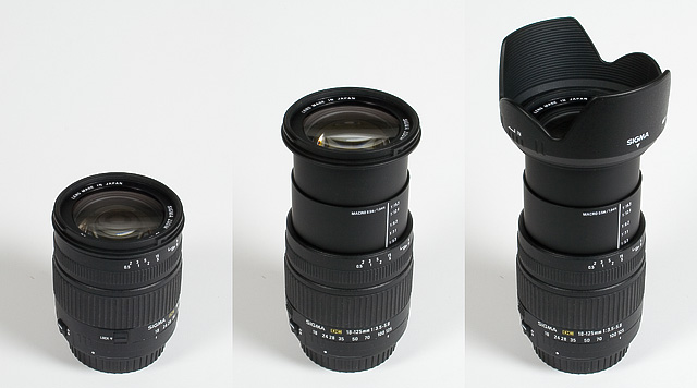

At its 18mm setting the lens is extremely compact at only 70x78mm. As you can see in the product shots above it extends significantly towards the long end of the zoom range and the included lens hood adds a few centimeters more here. The lens uses a so-called duo-cam system with two inner zoom tubes. At just 385g it is also a very light-weight lens. The aperture mechanism features 7 blades. The min. focus distance is 50cm resulting in a max. magnification of 1:5.3 at 200mm. The filter size is 62mm.
