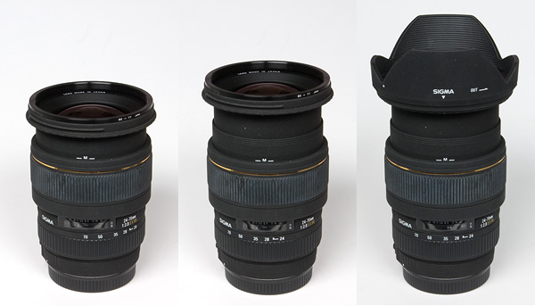

The Sigma is a rather massive standard zoom lens. It requires 82mm filters so be suffer when investing into a polarizer (although you may consider a step-down ring when using the lens on an APS-C DSLR). Interestingly its principal design is fairly similar to the Canon EF 24-70mm f/2.8 USM L - reads: it extends when zooming towards the WIDE-end of the zoom range which is relatively unusual. The product image below may suggest something else but the lens has only a single inner lens tube. The build quality of the lens is very fine thanks to high quality materials and smooth control rings (the rubber of the zoom ring of the tested (used) sample collected some dust over time). The lens suffers a bit of zoom creeping though.
