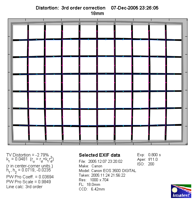

The level of distortions varies across the zoom range. At 18mm there're quite extreme barrel distortions - nothing for architecture photography where you prefer straight lines to remain straight. Towards 28mm the situation eases a bit but there're still some pronounced barrel distortions here. At the 50mm setting the lens is virtually free of distortions.
18mm:
28mm:
50mm:
