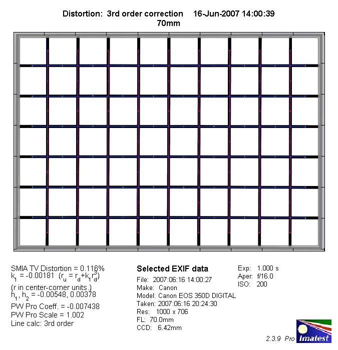

Typical for macro lenses the Sigma shows an extremely low level of distortions (~0.1%) which is absolutely negligible in field conditions.

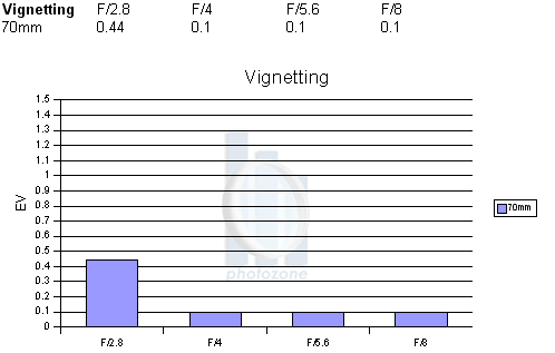

Thanks to the sweet spot behavior on APS-C DSLRs the vignetting is very well controlled here. The lens remains perfectly usable in this respect even at max. aperture (f/2.8).

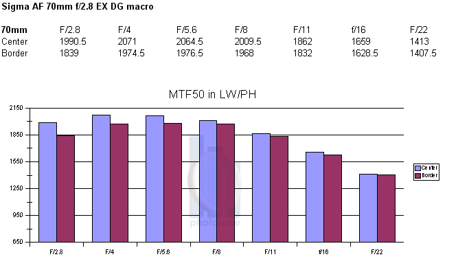

Macro lenses tend to be stellar performer thanks to a usually very conservative max. aperture and the Sigma follows this tradition. The resolution characteristic is generally excellent straight from f/2.8 all the way down to f/11 with a slight peak in the f/4-5.6 vicinity. Due to the usual diffraction effects the resolution is reduced to very good levels at f/16 and good quality at f/22.
Please note that the resolution tests are performed at conventional focus distances. True macro tests are not possible at this stage.

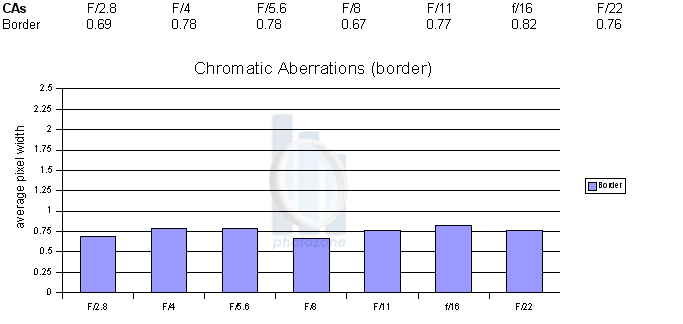

Lateral CAs (color shadows at the image borders) are relatively well controlled although an average pixel width of around ~0.75px at the borders isn't really low for a fix-focal lens. However, the problem is still not overly field-relevant. There're only very minor traces of purple fringing at f/2.8.
Please note that lateral CAs can be corrected without any significant impacts via tools.
