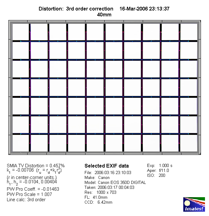

The lens shows a medium degree of barrel distortions at 24mm changing to moderate pincushion distortions towards the long end of the zoom range. The neutral settings should be a little below 40mm. Not all that bad for a 5.6x zoom ratio.
24mm:
40mm:
75mm:
135mm:
The chart above has a real-world size of about 120x80cm or 40x the focal length. Expect more distortions towards closer focus distances.
