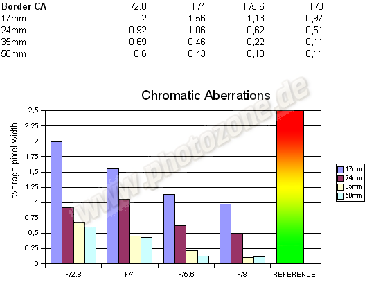

Chromatic aberrations (color shadows at harsh contrast transitions) are relatively well controlled except at 17mm at large aperture settings where the issue is very pronounced with a peak of 2px on the average at the image borders. Stopping down reduces the issue but you will need to stop down to f/8 in order to suppress the problem to uncritical level. At the other focal lengths CAs are a far lesser problem. Please note that CAs can be quite easily corrected in most modern RAW converters or via tool support.
