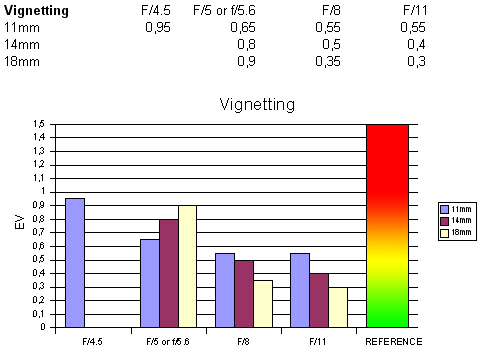

The vignetting characteristic of the Tamron is pretty good for an APS-C ultra-wide lens with a light falloffs of less than 1EV at wide-open aperture. One stop down the issue is already well controlled.
