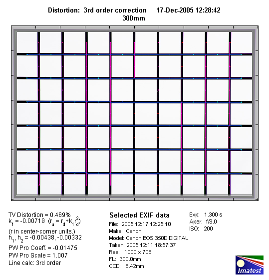

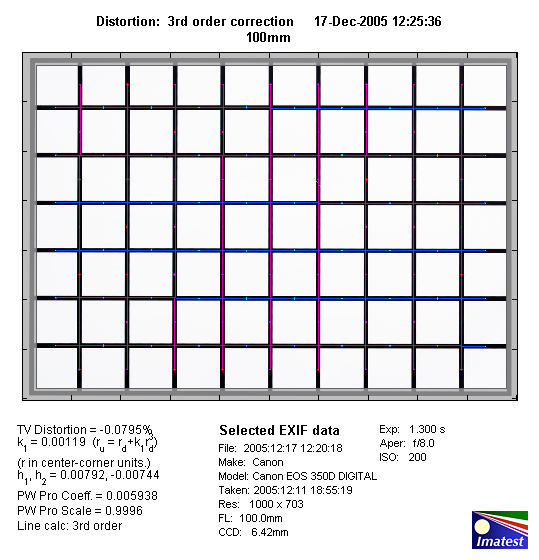

The level of distortions is very low throughout the zoom range. At 100mm the lens is free of distortions changing to very slight pincushion distortions at 200mm and 300mm.

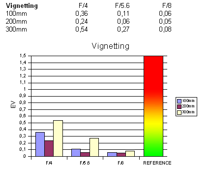

Oan APS-C DSLR the lens can take advantage of the sweet spot effect so the vignetting isn't overly pronounced. At 100mm and 200mm the issue is basically negligible. At 300mm the situation deteriorates somewhat but even at f/4 it requires quite critical scenes to see some vignetting and stopping down a little resolves the issue completely.

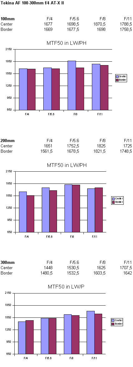

Regarding the pro grade AT-X designation the lens performed a little worse than expected in the lab. At 100mm and 200mm the Tokina was able to deliver very good results at wide-open aperture increasing to excellent results at f/8. Unfortunately there´s a quite pronounced drop in quality at the 300mm setting to only good figures at f/4. There´s a gradual improvement towards f/8 where the performance is in very good territory again. While not formally measured the lens also suffered from reduced contrast at 300mm and large aperture settings.

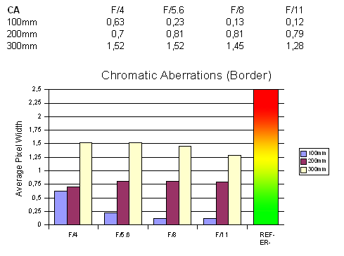

Chromatic Aberrations
The lens produced a varying degree of chromatic aberrations (color shadows at harsh contrast transitions) at the image borders. At 100mm and 200mm CAs are no big problem. The situation changes at 300mm where the average CA pixel width exceeds 1.5 pixels which is very pronounced for a tele lens.
