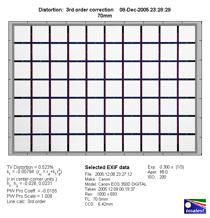

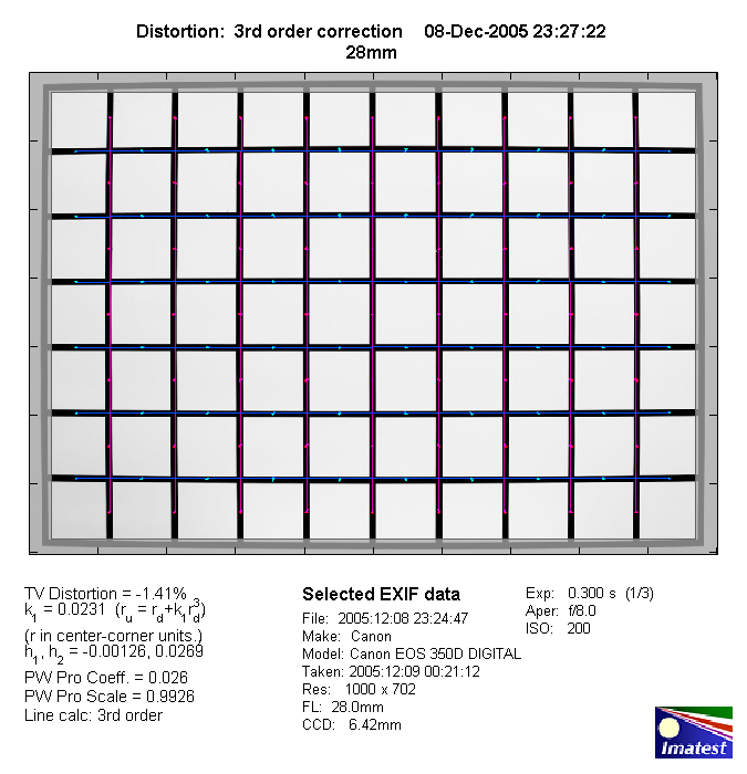

The lens shows some quite pronounced barrel distortions at 28mm changing to slight pincushion distortions at 40mm and 70mm.
28mm:
40mm:
70mm:
As usual you should probably expect more distortions towards closer focus distances.

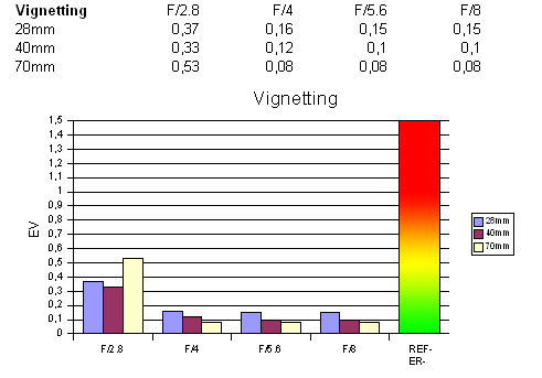

The AF 28-70mm f/2.8 AT-X Pro SV is a full frame lens so it can take advantage of a sweet spot effect on APS-C DSLRs. Vignetting is almost no issue except maybe at 70mm @ f/2.8 where it may be noticeable in extremely critical scenes. A very good performance here for a standard zoom.

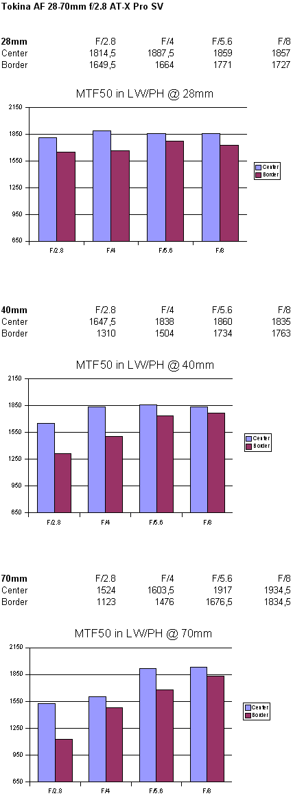

The Tokina exhibited a good but mixed performance under lab conditions. At 28mm the lens was capable to produce very good to excellent results throughout the tested aperture range. At 40mm the corner performance suffered substantially at wide-open aperture whereas the center quality remains on a very high level. At f/4 the corners catch up to good lenses increasing further till f/8 with very good results again. At 70mm the lens is quite soft at wide-open aperture with pretty bad corners. The quality increases gradually towards medium aperture settings peaking at f/8 in excellent resolution figures even including the corners.
It is worth to mention that the lens suffered from a slight centering defect at 28mm.

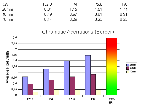

Chromatic Aberrations
Chromatic aberrations (color shadows at harsh contrast transitions) vary quite a bit according to the chosen focal length. At 28mm the problem is most pronounced exceeding an average CA pixel width of 1.5 pixels at the image corners at and beyond f/5.6. At 40mm and more so at 70mm the issue is quite a bit less pronounced.
