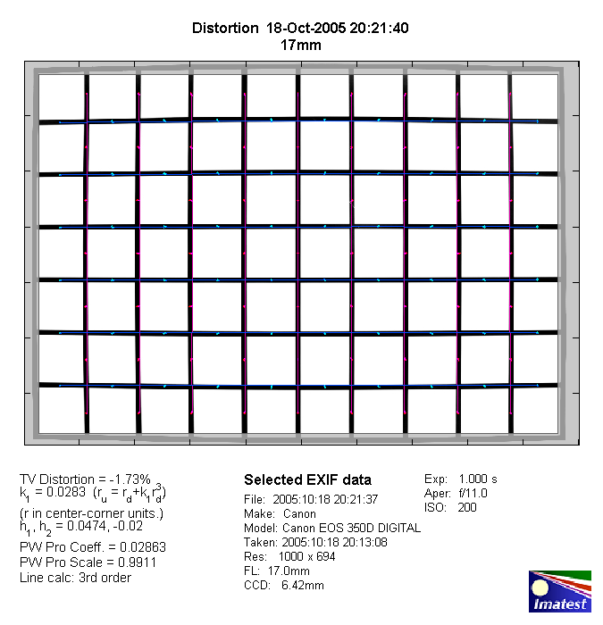

Typical for many wide to ultra-wide lenses the Tokina AF 17mm f/3.5 AT-X Pro exhibits some barrel distortions. They're relatively pronounced here at about 1.7% but that's still quite a bit less compared to the Canon standard zooms in this range (but not better than the ultra-wide zooms).

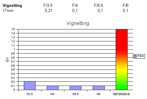

On the EOS 350D with its reduced format (APS-C) the (full format) lens fully enjoys the sweet spot behavior with vignetting figures that are already totally negligible at wide-open aperture. Quite an amazing performance here.

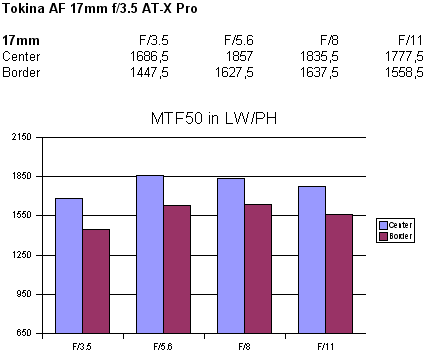

The lens exhibited a quite even performance in the lab with a good to very-good center and slightly worse borders figures throughout the tested aperture range. Nothing special but solid.
Below is a simplified summary of the formal MTF findings. The chart shows in line widths per picture height (LW/PH) which can be taken as a quantity for sharpness. If you want to know more about it you may check out the corresponding Imatest Explanations.

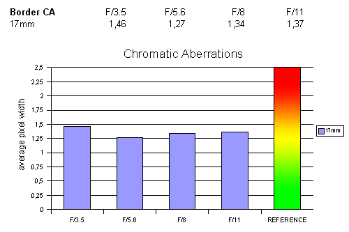

CAs (color shadows at harsh contrast transitions) are a little on the high side with an average CA pixel width between 1.27 and 1.46 pixels at the image borders. Relatively speaking this is in line with the better zoom lenses in this range.
