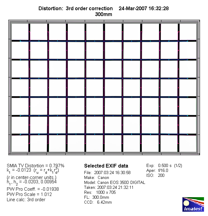

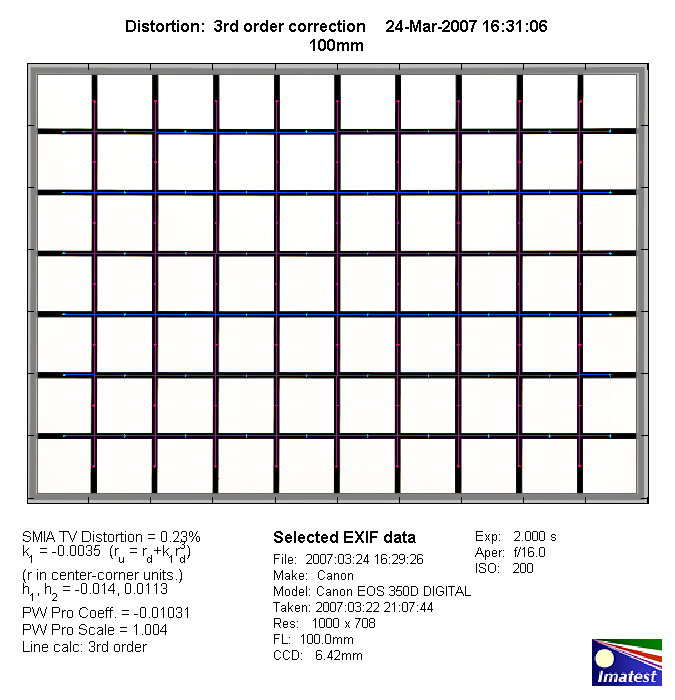

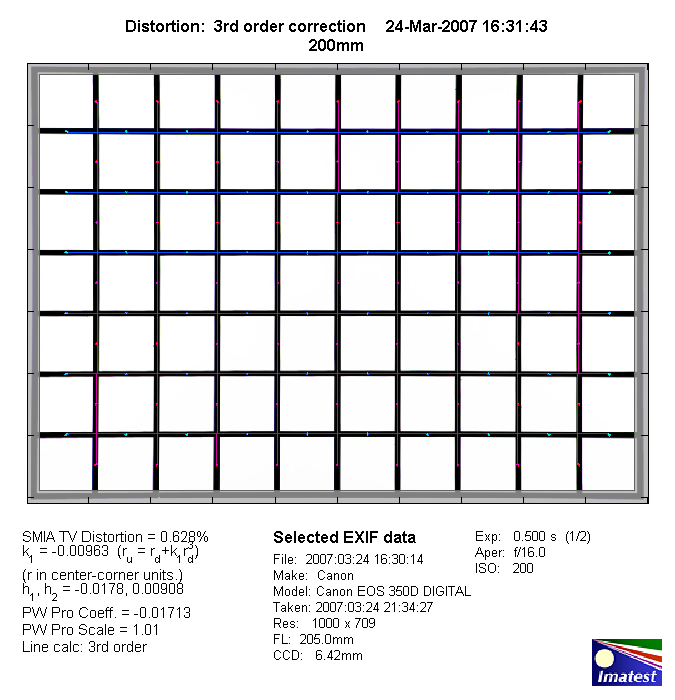

The level of distortions is quite low throughout the zoom range. At 100mm there's a tiny bit (0.23%) of barrel distortions changing towards moderate pincushion distortions at 200mm (0.64%) and 300mm (0.8%).
100mm:
200mm:
300mm:

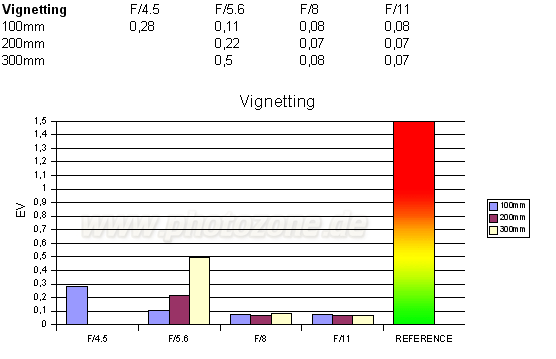

Used on an APS-C DSLR the vignetting is very well controlled thanks to the sweet spot advantage here (1.6x crop factor). At 300mm f/5.6 the issue is marginally more pronounced but even here the vignetting will be rarely field relevant. At all other settings vignetting is negligible.

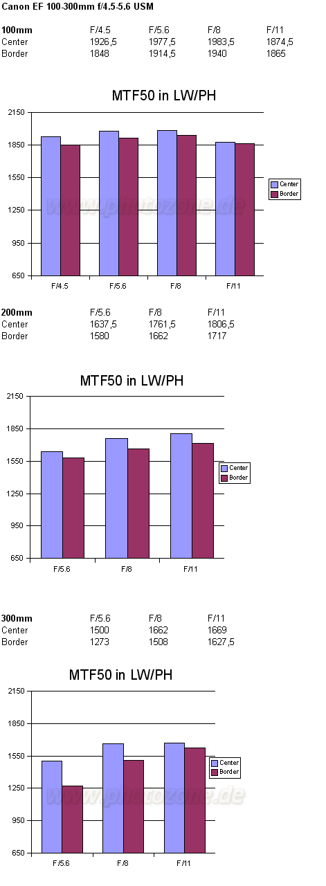

As to be expected the EF 100-300mm f/4.5-5.6 USM delivered a good but not overly exciting performance in the MTF lab. At 100mm the resolution is very high with excellent figures throughout the tested aperture range. Moving on the 200mm there's already a slight decrease in performance specifically at wide-open aperture. Nonetheless the lens remains usable here. At 300mm the lens is rather soft at f/5.6 but stopping down to f/8 or f/11 lifts the quality substantially. At wide-open aperture the contrast level is also somewhat reduced here.
It is also worth to mention that the lens showed a very good centering - a rare occurrence in this lens class which does surely also originate in the IF design.

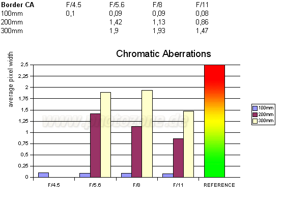

Lateral CAs (color shadows at harsh contrast transitions) are a weakness of the EF 100-300mm f/4.5-5.6 USM. At 100mm the issue is surprisingly negligible but at 200mm and more so at 300mm the CAs are rather extreme with peaks around 1.4px (200mm) and 2px (300mm) at the image border. This is a critical level which is easily visible in field shots. Nonetheless lateral CAs can be corrected or at least reduced via imaging tools like Photoshop or various RAW converters so it is no principal show-stopper if you're willing to invest some efforts here.
