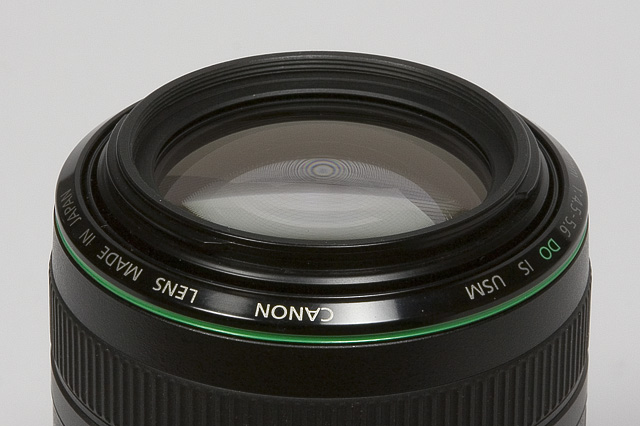

The DO element is also visually recognizable (unlike UD or CaF2 elements). In the image below you may notice the concentric circles in the glass.

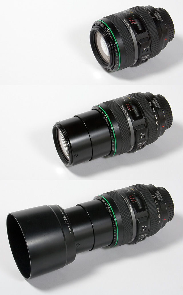

    As you can see above the lens has a rather conventional mechanical design. It extends towards the long end of the zoom range. Size-wise it is fat lens being very short (28% shorter according to Canon) for such a tele photo lens but with a very large lens diameter. At 720g it isn't especially light weight but the pretty good build quality, located somewhere between Canon consumer grade and L class lenses, takes its toll here. As a negative side effect of the additional weight the zoom mechanism has a rather strong tendency to creep when tilting the lens up- or downwards. Canon has integrated a zoom locking switch but unfortunately this works in the 70mm position only.
