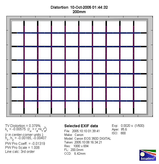

The level of distortions is very low for a zoom lens with very slight barrel distortions at 70mm and minor pincushion distortions at 135mm, 200mm and with attached EF 1.4x II. An exceptional performance similar to the EF 70-200mm f/4L and the EF 70-200mm f/2.8 L IS.
70mm:
135mm:
200mm:
280mm (w/1.4x):
The chart above has a real-world size of about 120x80cm. Possibly expect more distortions towards closer focus distances.
