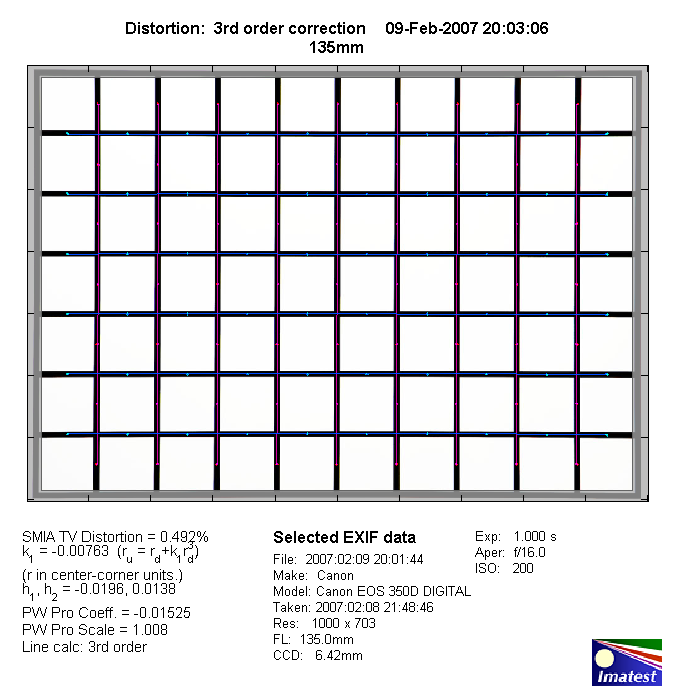

The level of distortions is about average for a tele zoom lens with a moderate degree of barrel distortions at 55mm changing to slight pincushion distortions at 135mm and 200mm.
55mm:
135mm:
200mm:
