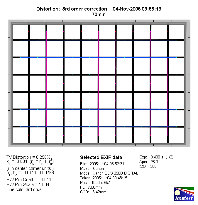

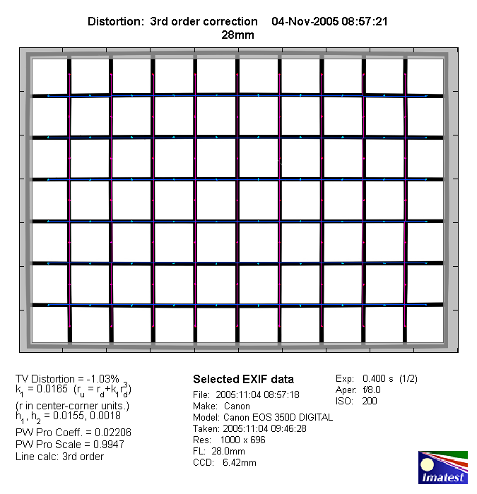

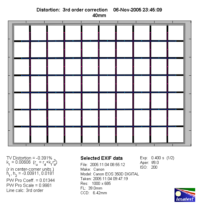

The level of distortions is very low for a standard zoom lens with slight barrel distortions at 28mm and marginal pincushion distortions at 70mm.
28mm:
40mm:
70mm:
The chart above has a real-world size of about 120x80cm. Possibly expect more distortions towards closer focus distances.

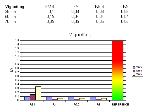

On APS-C DSLRs vignetting is extremely low and not field relevant at any focal length and aperture.

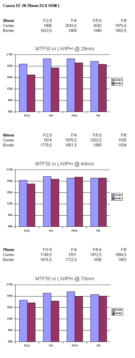

In the lab the lens showed a very good to excellent performance across the range. In fact it proved to be slightly better than its successor here which may originate in the slightly reduced range. And it's truly as good as many fix-focals in its range which is quite baffling.

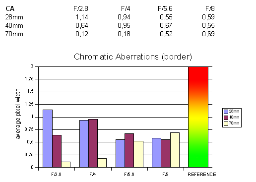

Chromatic Aberrations
The lens produced a medium degree of chromatic aberrations (color shadows at harsh contrast transitions) at the image borders. CAs are most pronounced at 28mm and 40mm where the average CA pixel width is around 1 pixel at the worst. At 70mm the problem is little reduced. Overall this is a decent performance for a zoom lens. Please note that CAs can be (auto-)corrected via imaging tools.
