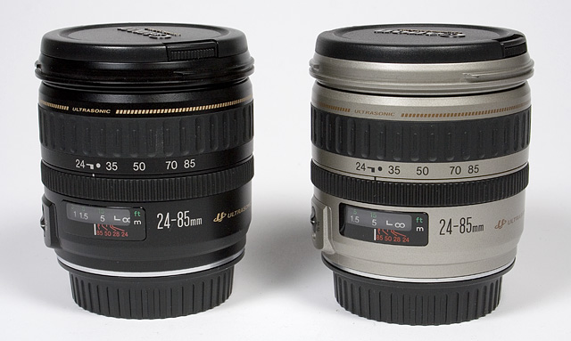

Originally the lens was released in two different flavours - a silver colored version for APS SLRs (film) and a black version which is still marketed today. Officially there´s no difference between the two though there´re rumors that the silver version is somewhat better.
The build quality of the lens is pretty good - not quite comparable to Canon L lenses but the platic quality is decent and there´re few wobbling parts despite the duo-cam zoom construction. Both the zoom as well as the focus ring operate reasonably smooth though not overly well damped.

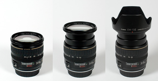

The EF 24-85mm f/3.5-4.5 USM has a very fast and virtually silent ring-type USM drive featuring full-time manual focusing (FTM) in AF mode. The front element does not rotate so using a polarizer is no problem. The lens comes without any special accessory but a dedicated lens hood is available.
