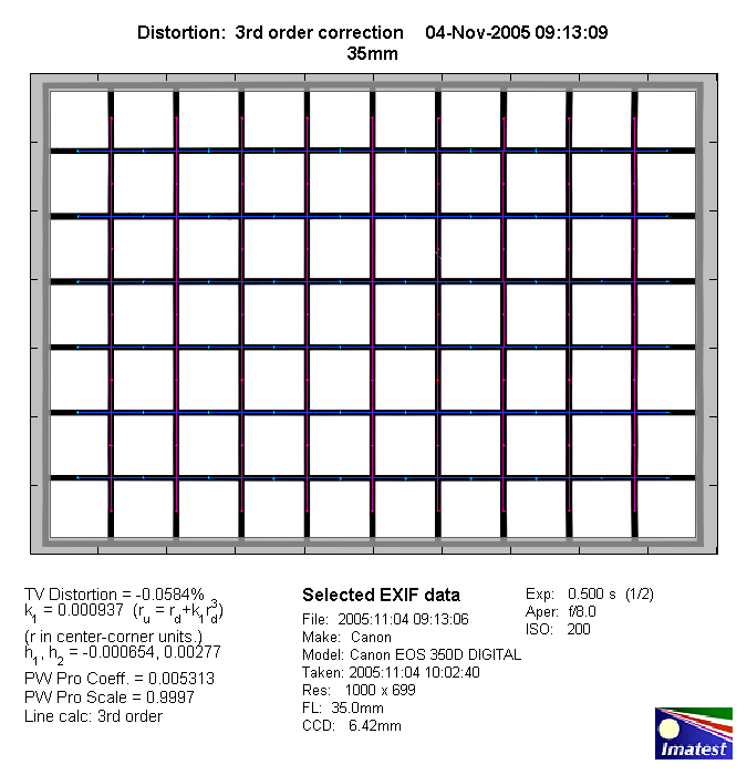

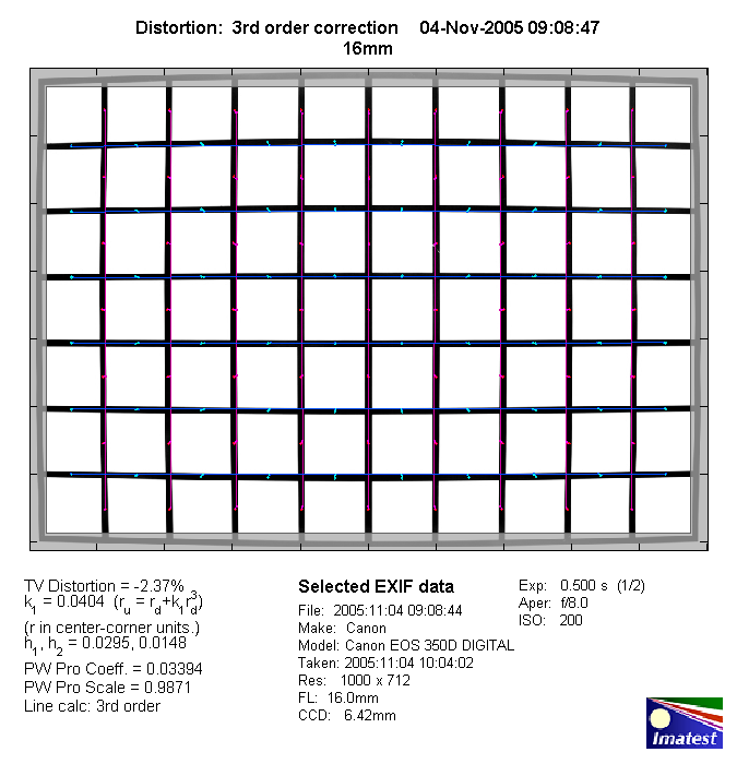

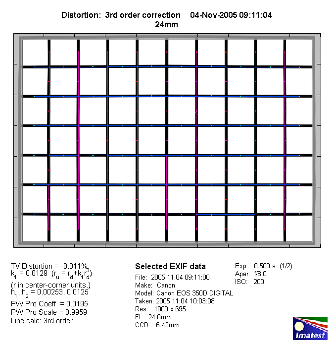

The lens shows some very strong barrel distortions at 16mm easing towards the long end (35mm) where the lens is basically free of distortions.
16mm:
24mm:
35mm:

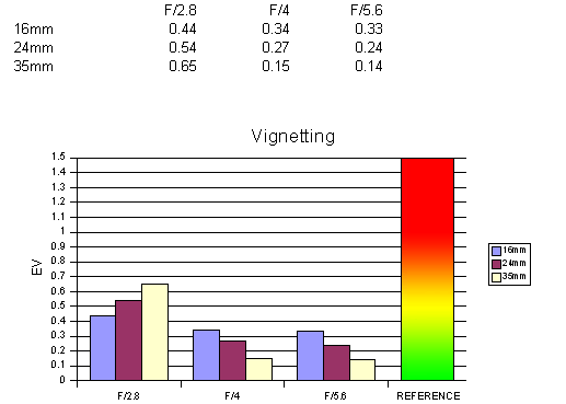

The EF 16-35mm f/2.8 USM L is a full frame lens so it can take advantage of a sweet spot effect on APS-C DSLRs and vignetting is indeed on a very low level here. Surprisingly it is a little more pronounced towards the long end of the zoom range - possibly a side effect of the APS-C sensor crop.

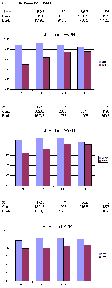

The lens exhibited a very good but slightly varying performance in the lab. The center performance is excellent throughout the zoom range with a superb peak at 24mm. Unfortunately the border quality isn't quite up to that level specifically at large aperture settings at the wide and long end of the zoom range. The extreme borders at 16mm (not shown in the graph below) suffered from field curvature effects. As usual the quality can be increased by stopping down resulting in very good (16mm and 35mm) to even excellent (24mm) levels.
Two samples of the lens were tested during the recent months. The first one tested in late '05 showed slightly better figures at 35mm and slightly worse at 24mm. However, in the field the results were somewhat sub-standard under certain conditions so the lab results were not taken into account here despite a statement by the Canon Service that the lens was within specs.

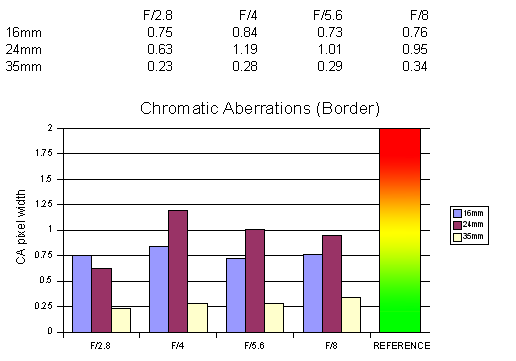

Similar to the resolution figures the chromatic aberrations (color shadows at harsh contrast transitions) are in line with what we've seen from other classic ultra-wide zooms. In absolute terms CAs are quite high at 16mm and more so 24mm.
