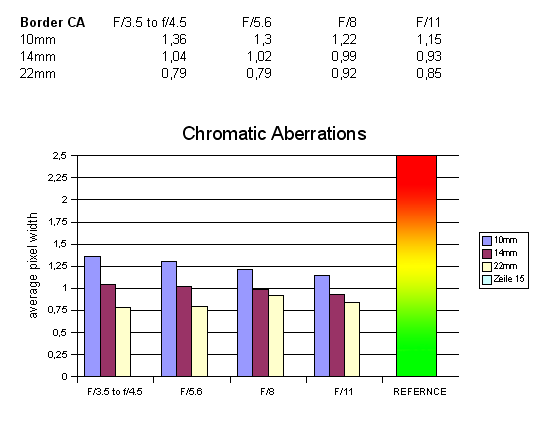

The EF-S 10-22mm produced another surprise regarding chromatic aberrations (color shadows at harsh contrast transitions) - for an ultra-wide lens they can be considered as quite low. In absolute terms CAs can be noticeable at 10mm and 14mm where they exceed an average pixel width of 1 pixel at the borders. This is still very respectable here. CAs can be corrected via imaging tools.
