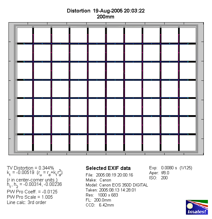

As expected for a fix-focal lens the level of distortions is quite negligible. The situation remains about the same when attaching an EF 1.4x II converter.

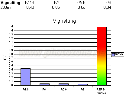

On the EOS 350D with its reduced format (APS-C) the (full format) lens exhibits slight vignetting at f/2.8 which shouldn't be much of a problem even at wide-open aperture. One stop down it is negligible even by lab standards.

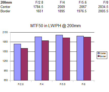

The EF 200mm f/2.8 L USM II (2nd sample) exhibited a very decent performance in the MTF lab. At wide-open aperture the resolution is very good and already quite even across the frame. The sweet spot is reached around f/5.6 with an excellent center to border quality.

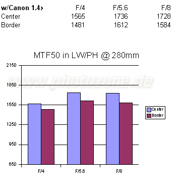

When attaching a Canon EF 1.4x II converter the quality decreases slightly with good (wide-open) to very-good (medium apertures) ratings - this is based on the 1st tested sample of the lens which performed slightly worse.

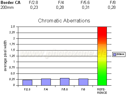

Similar to most other fix-focal lenses chromatic aberrations (color shadows at harsh contrast transitions) are extremely low and nothing to worry about.
