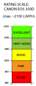

MTF (resolution & chromatic abberations)
The lens delivered a very impressive performance in the lab. The center resolution is excellent even at wide-open aperture followed closely by the borders which enter excellent territories from f/4 and up. It is no problem to use this lens at wide-open aperture which is surely a mainstream setting for such a portrait lens.
