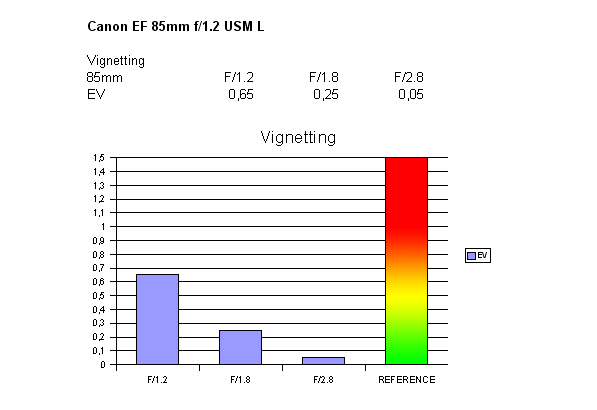

An ultra-large aperture lens is expected to vignette quite a bit and at f/1.2 you can indeed see quite pronounced vignetting of about ~0.65 EV even on an APS-C DSLR like the EOS 350D. In many cases this isn't a problem but it can be visible. It's quite save to assume that vignetting is quite a bit more pronounced on an EOS 1D series camera due to the bigger image sensor. On the EOS 350D and at f/1.8 the problem is already quite negligible and at f/2.8 it's basically non-existent.

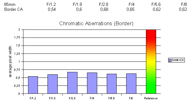

The chromatic aberrations (CA) don't exceed an average of 0.68 pixels at the image borders so they're quite low and usually no problem. The lens showed slight RSA (focus shift when stopping down - the MTF chart was revised accordingly).
