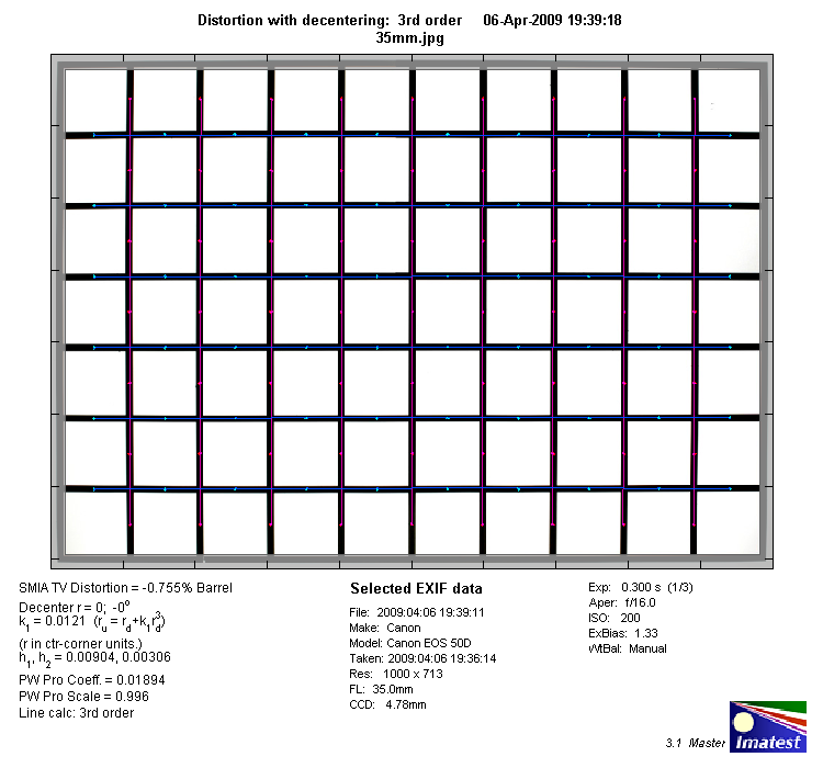

The lens shows only a minor degree of barrel distortion (~0.75%) - this is nothing to worry about in field conditions.
