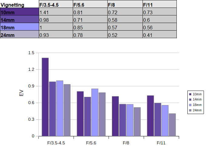

Compared to full cameras, vignetting is a harmless topic in the APS-C world. That being said - within the APS-C scope, the Tamron has its fair amount of issues here. The light falloff is worst (1.4 EV) at 10mm f/3.5 and around the 1 EV (f-stop) mark at other focal lengths at maximum aperture. Stopping down helps to reduce the vignetting but traces remain even at f/8 especially at the wide end.
Please note that there are also limits here due to the amount of "natural vignetting" that is always present at such wide focal lengths.
