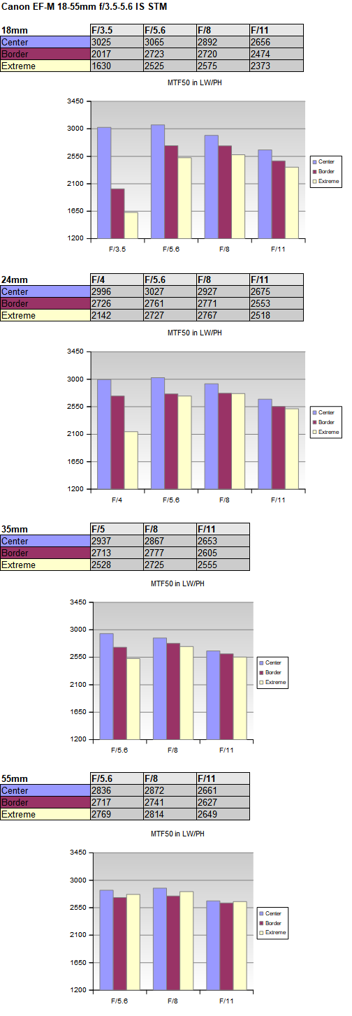

The resolution figures of the Canon EF-M 18-55mm f/3.5-5.6 STM IS are fairly decent. The center quality is very high at all focal lengths throughout the relevant aperture range (till f/11). Conversely, the outer image region is very weak at 18mm f/3.5 but improves drastically to good to very good quality when stopping down to f/5.6 already.
The corners are still a bit softish at 24mm f/4 but, again, that's no issue anymore at f/5.6. The image quality is evenly high at 35mm and 55mm without being tack sharp though.
