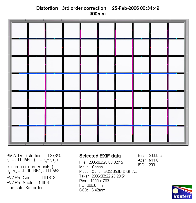

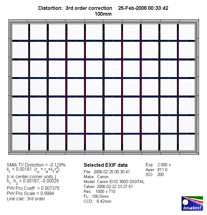

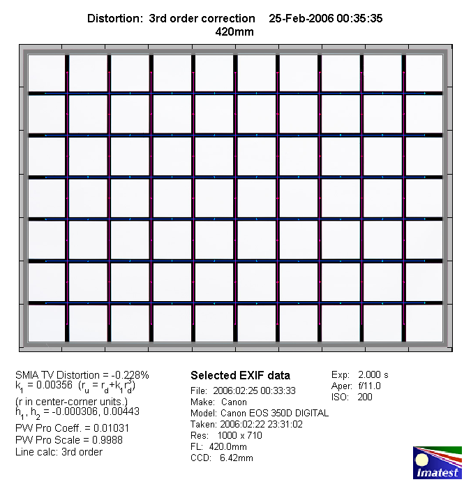

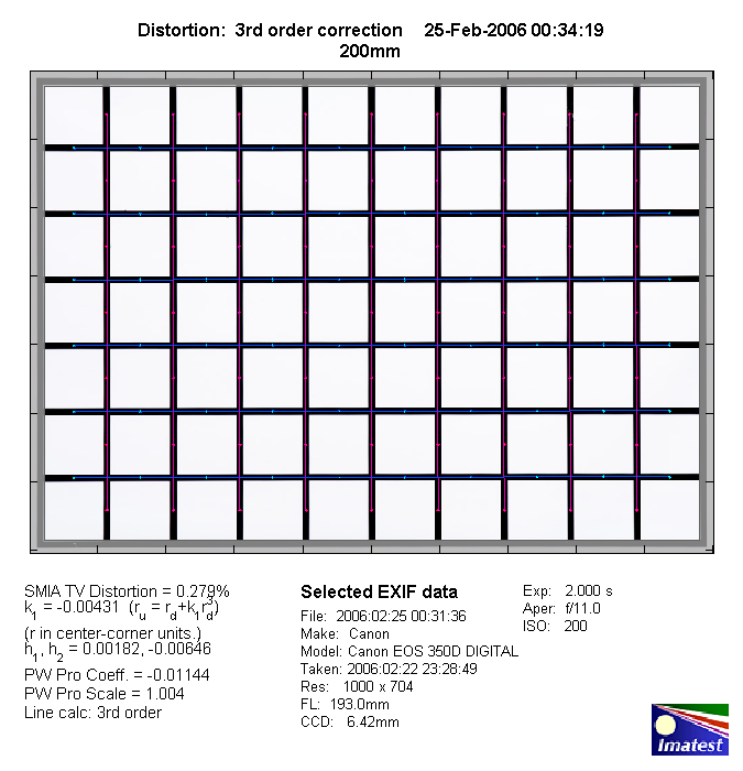

Distortion is exceptionally well controlled with with marginal barrel distortion at 100mm to marginal pincushion distortion at 300mm. The situation remains as good when combining the lens with the Canon EF 1.4x II converter.
100mm:

300mm:
420mm (300mm w/Canon EF 1.4x II):

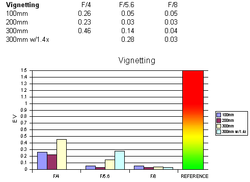

Typical for most full frame lenses it produces very little vignetting on APS-C type DSLRs. The issue remains below 0.5EV at all focal length at wide-open aperture. Vignetting is marginal in the 100-200mm range and slight at 300mm. Combined with the Canon EF 1.4x II is issue is not field relevant again.

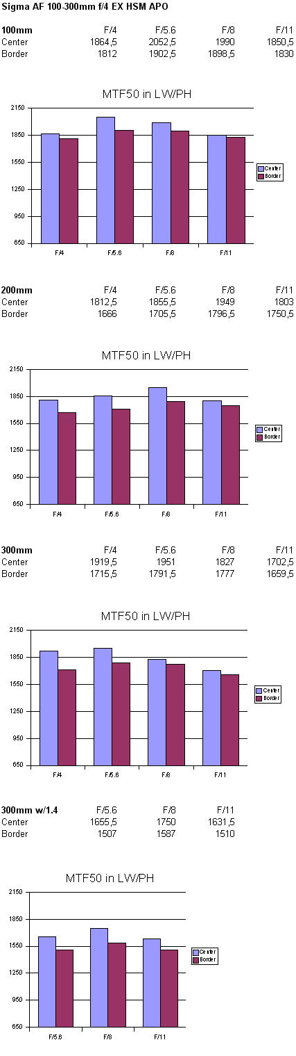

The lens was capable to deliver absolutely excellent resolution figures in the MTF lab easily comparable to fix focal length lenses in their respective range. At 100mm it even scratches the sensor limits of the 8mp sensor of the test DSLR. At 200mm and 300mm the center resolution is already excellent at wide-open aperture whereas the borders remain in very good territory. Very impressive!
Combined with the Canon EF 1.4x II there's a (natural) drop in performance down to a very good center and good borders.

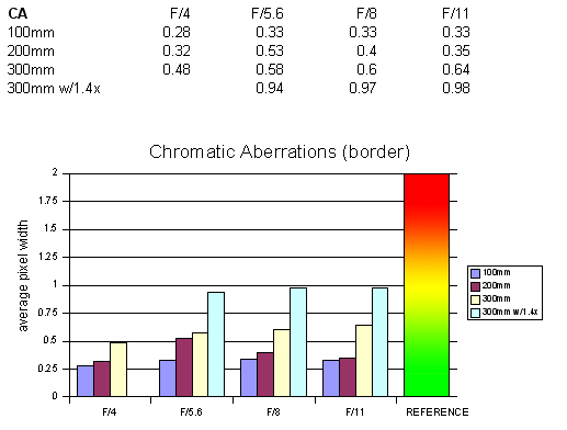

CAs (color shadows at harsh contrast transitions) are very low in the native 100-300mm range with a maximum of 0.64 pixels on the average at the image borders. The situation deteriorates significantly when adding the EF 1.4x II resulting in already noticeable CAs widths of around 1 pixel.
