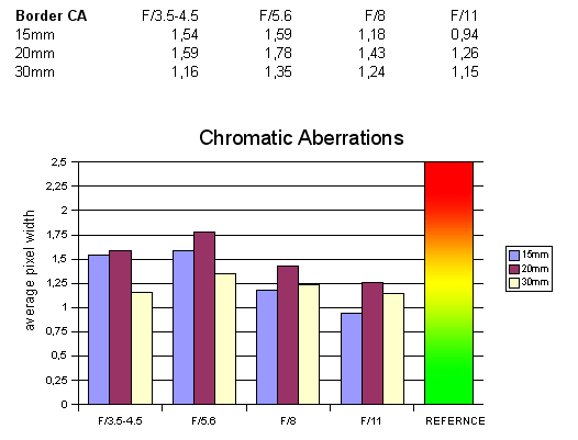

Chromatic aberrations (color shadows at harsh contrast transitions) are very pronounced with this lens but not much worse than the rest of the gang (in this lens class). As usual for an ultra wide lens the problem is most pronounced towards the wide end of the zoom range where the average CA pixel width varies around 1.5 pixels on the average at the image borders.
