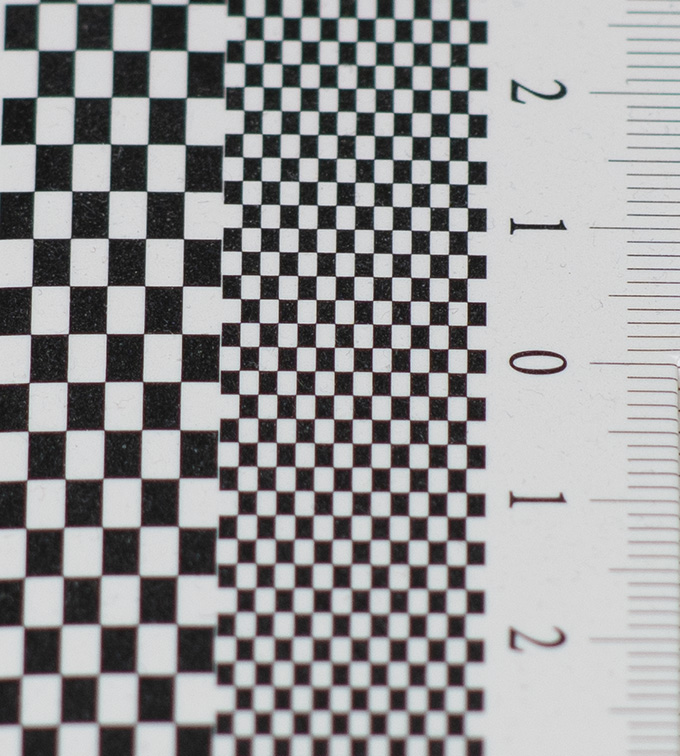

The Canon FD 135mm f/2.5 S.C. may be old but it still holds its own even on a high-megapixel camera. It's not the last word in terms of maximum performance but the lens is already pretty sharp at f/2.5. The center reaches very good levels and the outer field isn't too far behind. Stopping down to f/4 boosts the quality and the dead center is even in excellent territory. Stopping further down to f/5.6 results in a marginal improvement only. Diffraction affects the results from f/11.
The field curvature is low. The centering quality of the tested sample was good.

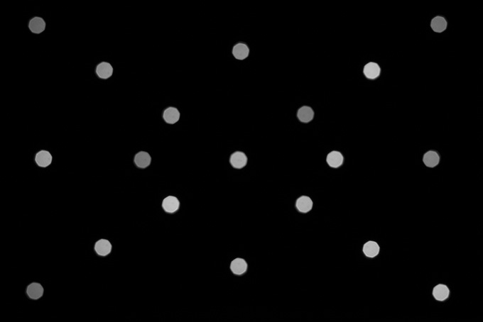

Out-of-focus highlights are nicely rendered with a smooth inner zone and no outlining. Typical for lenses of this time period, the more edgy aperture shape is already showing up at f/4. At the time, rounded aperture blades, which could mitigate the issue, were not invented/used yet.
When looking at the whole image field, the highlight discs don't stay circular outside of the image center but deteriorate to "cat eyes". However, the deterioration is still moderate. Stopping down to f/4 restores the "circular" shape at the expense of the edgier rendering.
The quality of the general blur in the focus transition zone is good in the background (shown to the left below) although we have seen better results from other vintage lenses - you may notice that the blur isn't really symmetrical. The foreground blur (to the right) is better than average but still not perfect.
